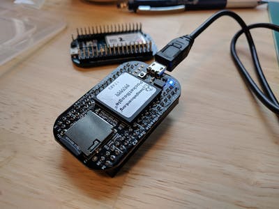

Plug in your PocketBeagle!

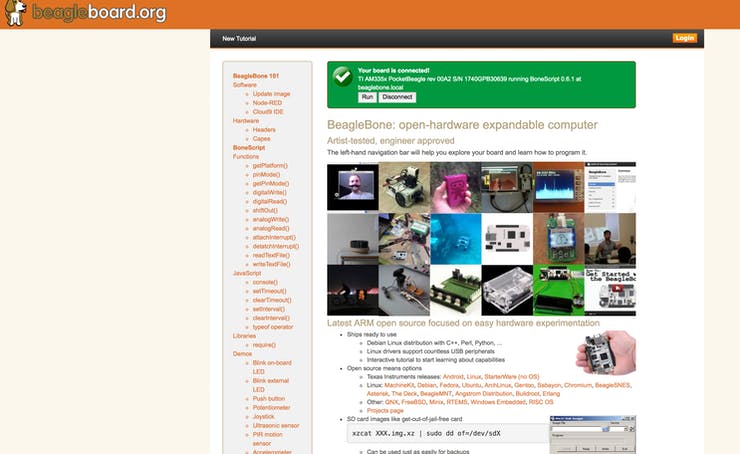

You’ll see LEDs for USB0, 1, 2 and 3 light up, assuming you have a working SD Card in your device. The USB in this case is operating as a virtual serial port, a mass storage device (it should show up as a drive) and an ethernet connection to the linux system on your Pocketbeagle.
If you’re on mac, you will be able to access the launch page for the device at
http://192.168.6.2/
on your browser (the address for Windows is
http://192.168.7.2/
, don’t bother with that one in other guides)
