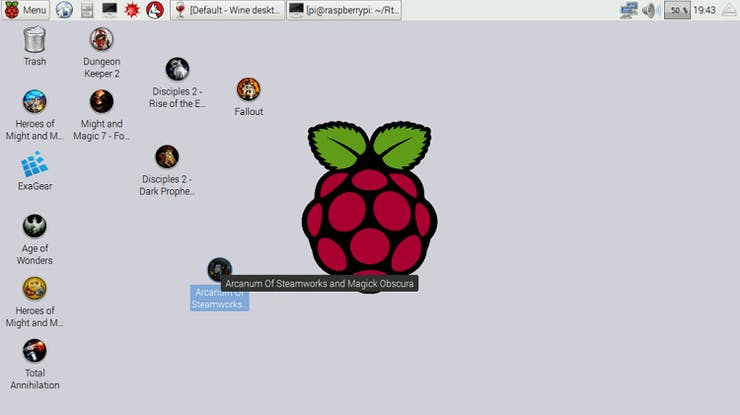

To install Arcanum just run the installer with Wine in Terminal (command line), and the graphical interface of the game installer will show up:
$ exagear
$ wine setup_arcanum_2.0.0.15.exe
After installation is finished you can run Arcanum from your Desktop:

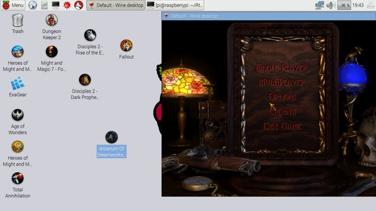

Wait a couple of minutes while Arcanum is loading, and finally, you will see the start menu.
Select your favorite hero and start playing Arcanum on Raspberry Pi!
