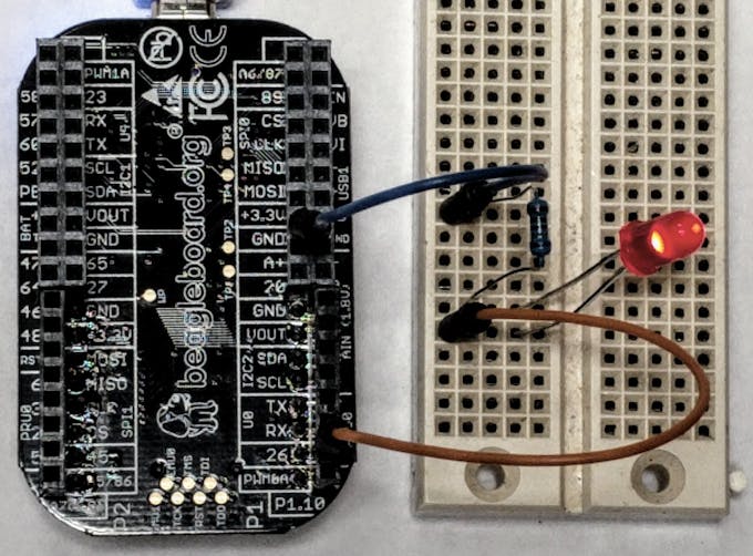

echo out > /sys/class/gpio/gpio111/direction
while :; do
> echo 1 > /sys/class/gpio/gpio111/value; sleep 1
> echo 0 > /sys/class/gpio/gpio111/value; sleep 1
> done
