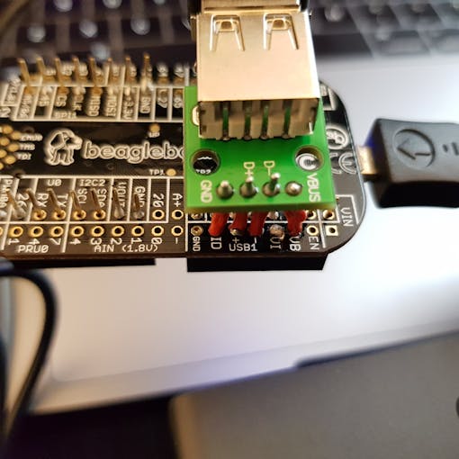

Adding a USB A port to PocketBeagle
First, you will need to add an additional USB port to your PocketBeagle headers so that it can interface with the Sound-Card.
To connect a USB Type A Female Receptacle Breakout Board to PocketBeagle, make the following connections:
PocketBeagle <--> USB Type A Female Breakout Board
- VB (P1.5) <--> VBUS
- VI (P1.7) <--> VBUS
- USB1- (P1.9) <--> D-
- USB1+ (P1.11) <--> D+
- USB1 ID (P1.13) <--> GND
- USB1 GND (P1.13) <--> GND
For more information see the PocketBeagle FAQ
Eshtaartha loves to solder, so we used wires to connect the USB card to PocketBeagle. You can also plug the breakout board to PB using male headers.

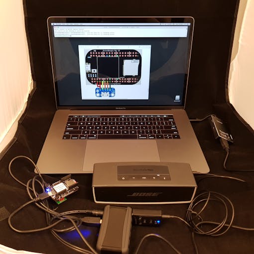

Power up PocketBeagle and connect to it using SSH. Then connect the USB hub and Sound Card. Check if the Sound Card is detected using the command
lsusb (lists all usb devices) or aplay -l (lists all sound cards) on terminal
Putting it all Together

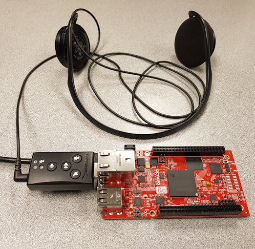

You can add text to speech in this manner using any OSD335x based development board. We also built the project using the Octavo Systems OSD3358-SM-RED Reference, Evaluation, Development Board. This board uses the same OSD3358-SM System-in-Package as PocketBeagle. The OSD3358-SM-RED has additional full development features included such as sensors, ethernet and USB on the board. The set up is shown below:
You can also run the project on other BeagleBoard.org Foundation BeagleBones that use the OSD335x System-in-Package devices.
