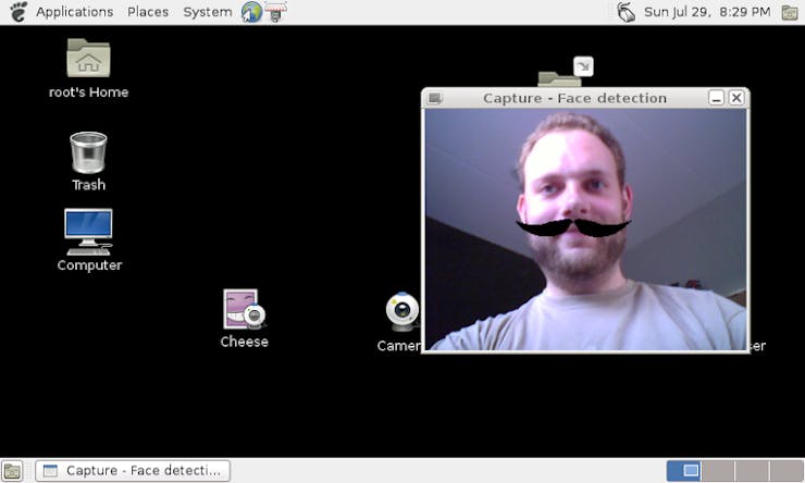

OpenCV-based face detection sample with added mustache
