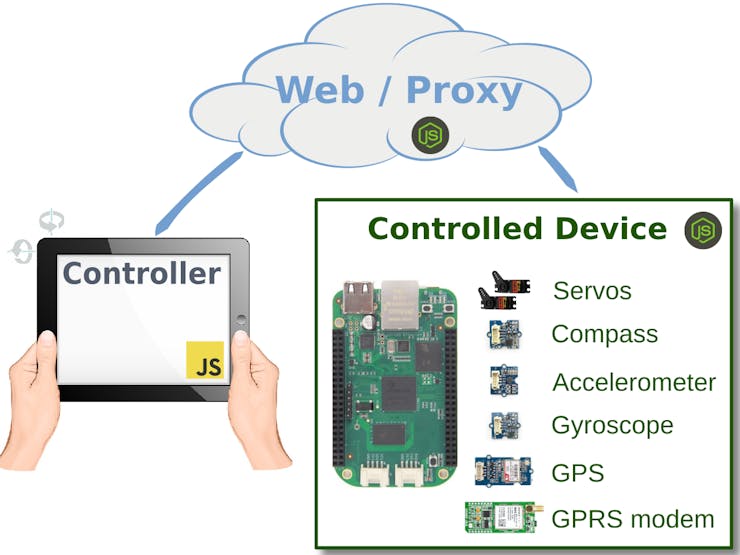

This article describes how to get the BeagleBone Green working as a remotely controlled device that can send back status updates (position and attitude) to the controller.
See the video below for the awesome demo. It shows the device connected to a sailboat, but you could connect it to anything.
It's simple, there is almost no soldering required - only the GPRS modem pins require soldering. We only use JavaScript as our programming language. This means, as an Internet of Things developer, you only need to focus on one language.
The full system I describe requires the following components, but you can pick and choose the components you need for your own project:
- 3-Axis Compass (i2c)
- 3-Axis Gyroscope (i2c)
- 3-Axis Accelerometer (i2c)
- GPS receiver (serial)
- GPRS Modem (serial, 2G GSM) - for the Internet connection
- 2x servos (PWM)
I will describe how to get each component working individually, including the complete code to see in the video demo. All the code is open sourced so you can contribute back to it.
Note: it works for the BeagleBone Black too. Heck, a lot of these instructions will also work on the Raspberry Pi too, but your mileage may vary and I can't support you for that.

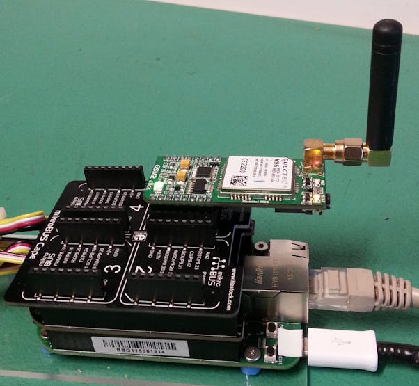

- GPRS Modem - how to get this going using pppd to connect us to the Internet.

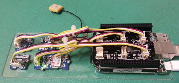

Planning the Physical Layout
Some things to keep in mind for the layout.
Aligning x, y, and z coordinates of devices
The accelerometer, compass and gyroscope all have an X-Y-Z graphic printed on the circuit board, see picture. You should align these together such that the board for each is in the same direction.
Accelerometer and gyro physically close
The accelerometer and gyroscope integrated circuits should be physically close to each other, this ensures when we put all the data together we take the information from one point.

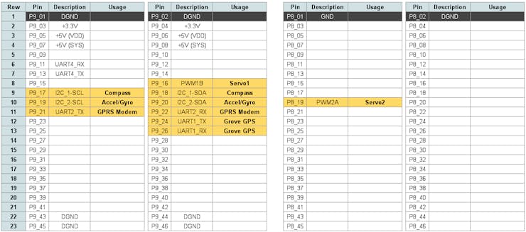

Plan Your Board Layout
It's best to plan a bit first, I suggest for each component, decide which pin it is going to occupy. I put this into a spreadsheet. Below is my plan along with the BeagleBone pins.

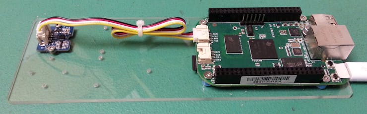

Accelerometer
The Grove 3-Axis Digital Accelerometer(±1.5g) has 3 orthogonal accelerometers. An accelerometer can measure gravity as well as acceleration/movement in a direction. Accelerometers are generally very noisy devices, I have seen this accelerometer fluctuate ±5 degrees when lying still. They also have a low resolution, meaning that smallest angle of resolution is 2.7 degrees from vertical. However, this is a know issue with accelerometers in general and when you pair them with a compass and gyroscope as well has use noise filtering you can reduce this issue.
This accelerometer measure a g-force up-to 1.5g, which is good for general use and swaying, but not good if you want accurate tap or knock detection. For that you need a larger range accelerometer, like this one.
First connect your accelerometer to your BeagleBone Green, see photo below. The BeagleBone i2c Grove connector is connected to the i2c-2 bus.
Communication is over the i2c bus, the Grove connectors make it seamless to connect to the BeagleBone Green. This accelerometer contains a Freescale Semiconductor MMA7660FC chip.
I wrote the accelerometer-mma7660fc library which is available on npmjs.org and GitHub. First we need to install the library, on the command line:
npm install accelerometer-mma7660fc
This will take a minute to download and install the accelerometer-mma7660fc library. It will create the node_modules folder (if not already there) and place the new library into that folder.

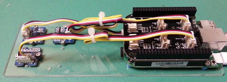

Compass
The Grove 3-Axis Digital Compass has 3 orthogonal magnetometers and can detect the Earth's magnetic field. Communication with this device is over the i2c bus. This compass contains a Honeywell HMC5883L chip.
Let's continue to build on top of the accelerometer and add the Grove Cape for BeagleBone Series and compass. You do not need the Grove Cape, but you can simply use the Grove i2c hub, it's a simpler and more elegant solution.
Push in the Grove Cape, this can take some force - but don't apply too much. Connect the compass to i2c-1 port of the Grove Cape. See photo below.

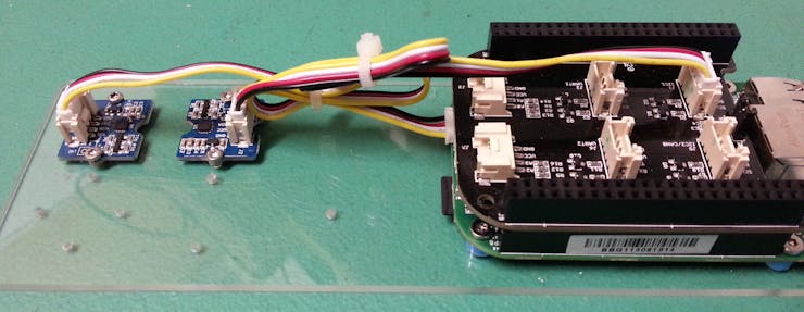

Gyroscope
Next up we add the Grove 3-Axis Digital Gyroscope, it has 3 orthogonal gyroscopes. A gyroscope (gyro) measures rotational acceleration. So when the device is at rest, all gyros will report values around zero. This SparkFun gyro contains a InvenSense ITG-3200 chip. Again, like the accelerometer gyros are generally noisy, so you will see the values fluctuate.
Connect the gyro to i2c-2 port of the Grove Cape. See photo below.

So I am using the GSM2 Click with a GSM antenna (MIKROE-275) on top of the MikroBus Cape. This device has the Quectel M95 FA GSM/GPRS module. Before you purchase it, make sure your cellular network provider supports the listed 2G frequencies. This device uses the serial port for communications, we will use UART2.
GPRS Step 1: Connect the hardware
The GSM2 Click comes with the pins unsoldered, you need solder these on - see section 2 of the GSM2 Click user manual for instructions. Insert the activated SIM card (standard size) into the SIM card slot and lock the slot. Attach the GSM aerial. Insert the GPRS modem onto slot 1 of the MikroBus Cape. And finally push the MikroBus Cape firmly on top of the Grove Cape. When powered on, you should see the yellow STAT light on and the red NET light flash.

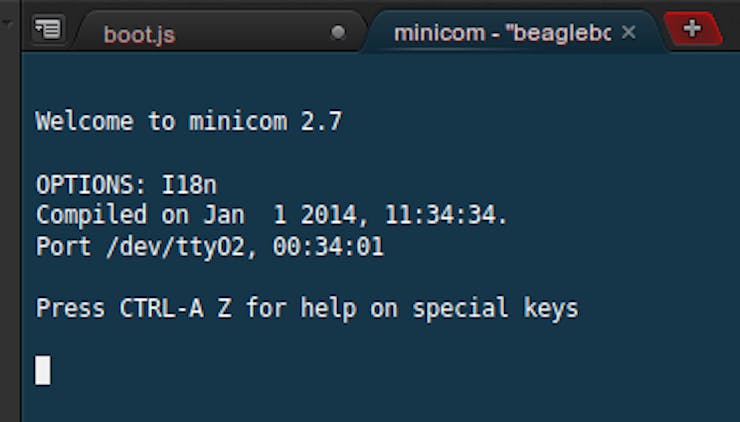

Once minicom is installed enter the following - this will start minicom at 9600 baud and connect us to UART2:
minicom -b 9600 -D /dev/ttyO2
You should see something like the following:

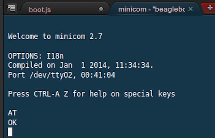

Now in the console type AT
and hit the enter key. You should get an OK
as the response, see image below. Congratulations! You are talking to the M95 GPRS modem.

In the steps above we have built all the necessary hardware and connected to the Internet. In this step we will set-up a solution to remotely control the servos and allow the device to send us status updates. This is the last step necessary to have a fully functional device. First I will explain the technology required to do this, then I will explain how to implement it.
Overview of the Solution
The diagram below shows the overview of the solution for the remote control and status updates. The components are:
- Controller: This is a smart phone or tablet, when you tilt the Controller it will send commands to the the Controlled Device via the Proxy.
- Controlled Device: This is our device we built, it connects to the Proxy and waits for commands from the Controller, while also sending status updates to the Controller.
- Proxy: This forwards commands from the Controller to the Controlled Device, and vice-versa for status updates. The Proxy also creates a web-server that serves content, the Controller is just a simple web-page served by the Proxy.
Why can't we communicate directly between Controller and Controlled Device? We could if we were on the same internal network. But once you are remotely controlling devices over a GSM/Cellular network it is generally not possible to directly communicate with a device. For instance, you can't directly access your phone's IP address over the internet, there are a few reasons, one is security.
